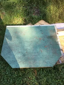

Hello all. Greetings from Michigan. I just found this forum today, lots of great information. I am wondering if anybody has had problems getting homeowners insurance with a non U.L stove? I am looking into switching to Farm Bureau Insurance to save around $600 per year compared to several other quotes I have gotten, but the agent stated that I would have to get a U.L. listed stove within 60 days. I love my Fisher stove and don't want to replace it, and I have no other use for it other than in my home. It meets all NFPA Code 211 requirements. The stove has been in this home for at least 40 years and is still in great shape. Has anybody else ran into this issue with insurance companies? I have had 2 other insurance companies in the past, and it has never been an issue, and they both came out and inspected it.
