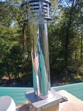

I have made all my updates that i needed to do before this winter.
Added 3 ft. to chimney...

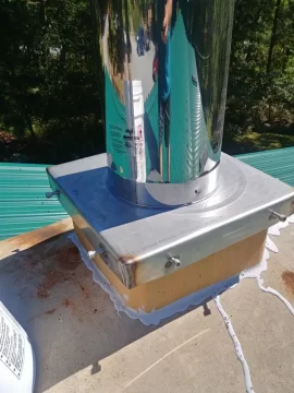

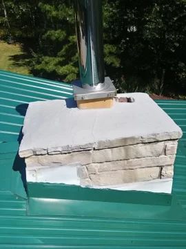

Put sealer on the chimney crown...
[Hearth.com] Interior fireplace with insert........

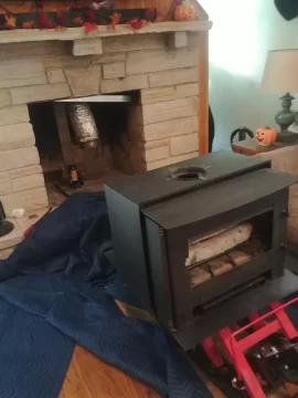

then installed block off plate...

What's with the fire grate inside the stove? Most wood stoves/inserts you would just build the fire directly on the firebrick floor. It maximizes your firebox size that way, as well.
Maybe it is off-season aesthetics.
