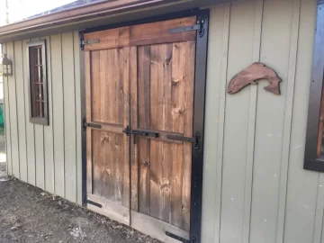

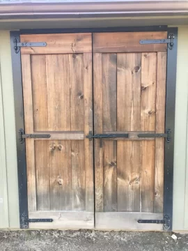

Hey Shorty,
Yes I expect to use pine. I made these doors for my shed and they came out ok. I used planks of pine over plywood and then added the trim.
I agree with Ashful as well...I expect to add weight to the bottom of the door to help keep it on track...guessing the door should be rather heavy.
My other issue is the door I plan on making needs to be rather narrow due to the space I have available...30inches wide maybe. Like Ashful implied...the narrower the door, the less likely it is to work well.
I’ll figure something out...I hope ;)

Hey Shorty,
Did you use a jointer then biscuit or pocket the planks? looks like there is some cap between them, or is that what you were going for. Either way they look pretty awesome shed doors
I'd use tongue and groove. The gap could come and go as the wood moves with seasonal humidity. Depending on the species of wood you choose, how it is sawn, and how its secured, you might see enough wood movement to cause splitting. Traditionally, this is the reason for frame and panel design.
Reactions: Ashful
Wow. I’ve owned a dozen barns, and not one of them had a jointed and biscuit joined door. Barn doors are shiplapped and cleated, with wrought nails bent over behind the cleats, or some newer facsimile thereof.
No jointer. Just slapped ‘em on the plywood. Actually I screwed the plywood into the planks from the inner-side of the door. I made sure the screw length was long enough to grab planks but short enough of course not to come through the planks.
