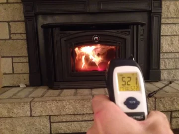

Just want to know if i am doing this right and measuring insert temp accurately.
When pointing laser to middle of glass i am getting 500 degrees from 4-5 feet away. Is this right method of temps? Thx

You can hold it close to the glass if you want and will still just get the glass temp..not the temp inside.
For a rough estimate on inside temps just double the reading .

Measure to the left of right of the thermometer on the stove door or body not off the glass.

The non-glass area of the door is measuring 225-250. Seems low. Does cast iron get as hot? The glass is at 525 now.
The firebox temp on the other side of the glass is not what you want to measure. You want to know the stove temp. The blower will cool things down. Turn down the air control until the flames get very lazy and see how the stove temps react.

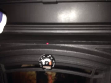

So if i laser the top of the stove where the air opening is, That would be more accurate? Pic attached you can see the red dot in air opening. Here i am getting 350. I also tried to shoot the flue collar thru the opening and got 260. stove room 72 after 4hrs since cold start and 35 outside. Thx all for help and info. [Hearth.com] IR Thermometer
Can't you get it further in there towards the center. You're looking for the maximum temp on the stove, generally that's going to be in the center of the top. But as I pointed out (for me) it can vary -- it's hotter on the top center as it's heating up, later on in the burn cycle, the front on top of the door is hotter. It's just helpful to have a better idea what's going on with your stove temp wise.
Edit: Okay I see, that's where you're getting the highest temp, fine.
btw, I didn't see Grisu's last message until after I posted my previous message, even though we were making similar points.
The point you are measuring is not really the stove top; try to get it more to the center of the stove top or take the flue collar. The temps you are getting sound a bit low. Do you have good secondaries? Is there smoke coming out of the chimney? I would try to get it up higher before closing off the air.

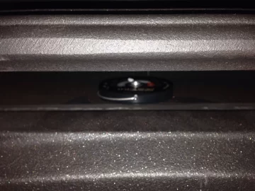

I put the magnetic thermometr in the air opening. Top center of stove top. Getting readings of 450 now. Is this a good spot? [Hearth.com] IR Thermometer
