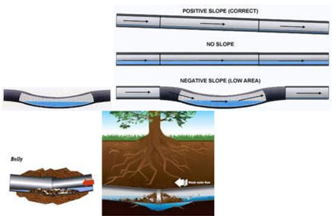

More info on sewer line sag issues
Reactions: Highbeam

More info on sewer line sag issues or bellies
