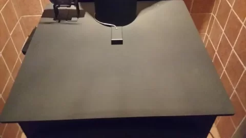

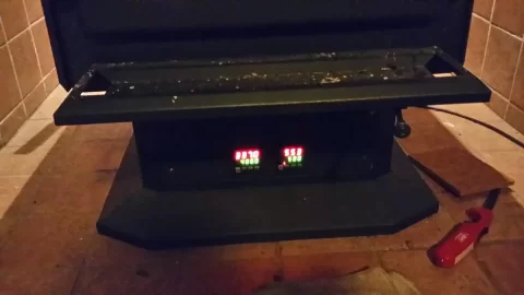

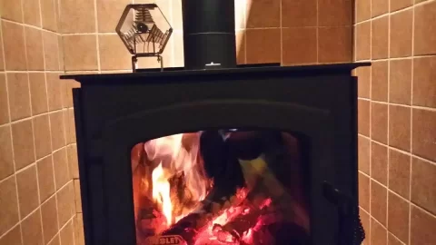

Here'a my setup. I used pid controllers so I could panel mount. One is for the stove top and one is the flue probe. All you can see is just the cord for the 120v source.
Nice and neat.
I forgot to add that the ash pan is removed and I made a custom panel that fit into the hole. Everything is reversible and no extra holes were drilled in the stove. I'm using the cheap pid controllers found on E-bay. The controllers are about $25.00 each.
