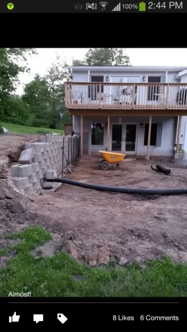

I have attached a picture of the house before it was done (what a nightmare!) It's the only one I have available at this time. What you are looking at is the ‘basement’ below with the new living up above. The proposed stove location is in the back left corner under out master bed.

It's 1300 upstairs and 1300 downstairs. The upstairs is all living area and the downstairs is basically half garage half walk-out basement, the picture you see is the new part. It's a terrible picture, imagine a 2 1/2 car garage to the right and living area above it.

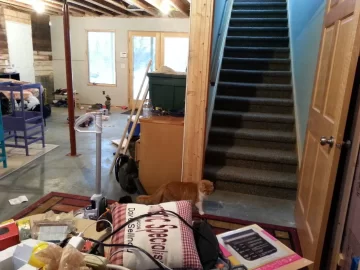

This is the stairway right in front of where the stove would go.this leads into the dining room with a vaulted ceiling, there is a big calling fan here that really moves the air. I'm thinking Napoleon 1900 or 1400 with a blower directing to the stairs. If needed cold air return sucking it from the far rooms and dumping into the stove room
Napoleon 1900 for sure.
