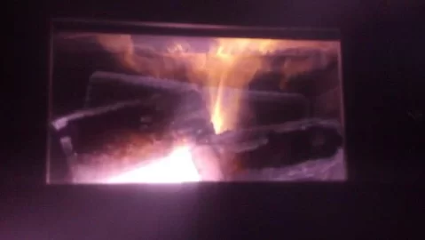

I added a couple more logs, pulled it back out to full open for about 10 min, then closed her back up to 50%. This is what it looks like now...
Are those flames still too big for the stove to start getting really hot?
