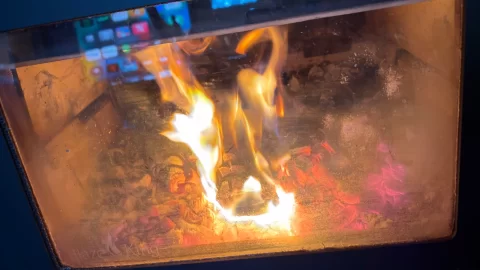

Also, another issue seems to be that the coals on the front of the stove get oxygen but those in the back don’t. The front glows, the back is very dark to black. You might be able to see in the picture. We don’t have a lot of wood in it at the moment as we’re deciding to empty all the coals or not at the moment.

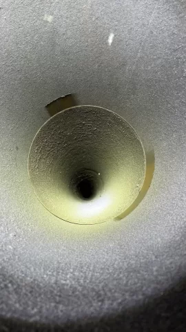

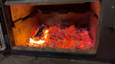

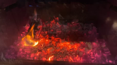

I don’t have a flue probe but 2 weeks ago, we inspected the pipe and vacuumed the cat from the front (I didn’t realize it was 4” deep so it might have more in it). After vacuuming it burned much hotter and better for a week or so. Here are a couple of pictures. The stove pipe and the strange “oxygen” pattern when the door is closed vs open. When closed with the damper fully open and the cat either bypassed or open, the back doesn’t seem to burn but the front does. Open the door with the cat bypassed and the entire coalbed lights up with happiness.

I can’t get it to burn any hotter. That’s the main issue. I have raked the coals forward and loaded wood to the back, That wood just chars and doesn’t really burn unless it comes forward. Ceiling fan is on full. We have a temp sensor at the top of the loft an down stairs so we know how much heat it up there.
The fact that after vacuuming it burned hotter is consistent with having too much draft.
Clean the passages,.and you get good burns. Then soon you end up with anemic performance again.
19 ft straight up is not much but with -20s F outside I think you have too much draft, quickly clogging up the cat, leading to the cat stalling, ending up with coals.
And when you open the door it is with the bypass open,.so no smoke rolling out because the draft immediately picks up as you bypass the clogged cat.

The fuel will always burn front to back. That’s because all combustion air comes from the air wash in the front glass. When properly loaded, full, you can’t see the back until the front burns away.
You can shove your cell phone up in front of the catalyst and take a picture looking into the cells to verify whether it’s clogged. Sure sounds like it. If so, you can sometimes blow it out or vacuum it out in place. Don’t remove the cat without a new gasket.

I talked to my dealer today about all the options and thoughts about the problems. In the end, I was told, and I believe him, that it is operating at max. I did just remove my catalyst and completely clean (carefully) and replaced with new gasket. He said the sad truth is that the best wood we have in Alaska is the best of the worst allowable wood in the world to burn. Birch just isn’t that dense and when it’s -32F outside, 4-6 hour burn times is all you’ll get at max with birch. He said a damper is a horrible idea and will cause serious issues and that the Blaze Kings essentially have all the damper you need. He agreed about using a fan on the box to extract all the heat you can get from it. And he showed everywhere I need to check and clean.
He mentioned we get clinkers all the time here because the Birch burns so fast that the coals just fall on the older coals and insulate them so shoveling out the firebox every 3-4 days may be required when it’s this cold out. Right now we’re at 5F, which feels like summer but we’re expected to get back to -30ish in the next couple of days so I’ll report back how the performance is doing.
