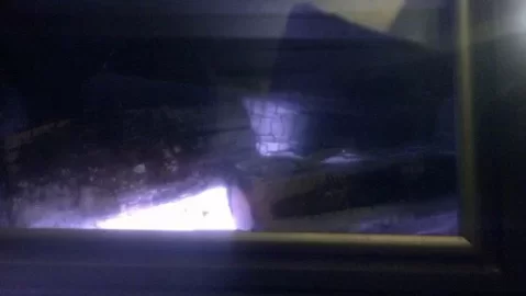

Is fire supposed to stop roaring when you lock the latch???
Lewisthepilgrim said:
I added a couple more logs, pulled it back out to full open for about 10 min, then closed her back up to 50%. This is what it looks like now...
Are those flames still too big for the stove to start getting really hot?
No that's fine let her go a little while at where u have it now ...eventually you will see more flames ... Let all the wood burn a bit .. then ease her down .. with your wood you don't want to completely close it I would say half of what you have now ...

yeah I closed it down to like 5 or 10% and it mostly died.
I just opened it back up to 25%. I think thats gonna be my magic number.....

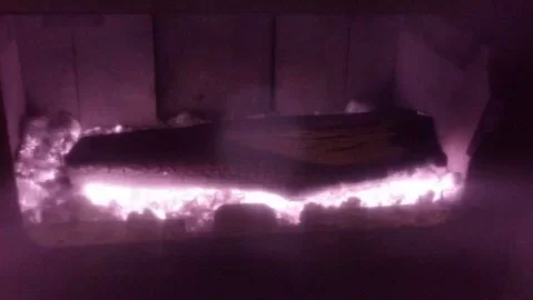

I'm having some issues.
Once you guys have a NICE thick REDHOT coal bed, do you ever need to use kindling again to get the logs lit again?
This log has been sitting on the coal bed for about 45 minutes and has not ignited. (it was roaring fire untill I closed the door and kept the damper FULL open)
When I do get the stove fire going at full bore I can BARELY boil water on the top of the stove in my little humidifier....I have tried all positions of the damper. It doesn't seem to get any hotter. When I dial down the damper, the secondarys get bigger, but the overall flame count defintely diminishes, no matter how long I wait to close it or how much I close it...
(still need to get a stovetop thermostat)
oldspark said:
That sounds like we are back to the green wood problem.
whats the best way to dry out my logs???
In a hurry? I assume yes, wood in the area of the wood burner will dry rapidly, is the wood split, small splits will work better.
Yup, sounds like unseasoned wood. Resplit them and get them into a very dry place. The house is ideal, but often that idea will meet with some resistance. If you can bring them into the house for a few weeks, it can really help. If that is not an option is there a basement or garage where they can be dried out with a fan blowing through them? Or can you buy truly seasoned wood and save the current stash for next year?

I cut a split in half with my miter saw and sure enough, literally about half the inside of the wood is darker in color! What a bunch of chit !
I bought this wood from a guy who seemed to know a little more than the other guys I talked to. It was also more expensive (300 a cord) He stated it was aged at LEAST 18-24 months.
