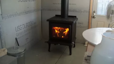

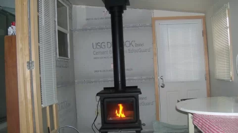

A bit of a follow up here. Not really too much to tell, but this is where I'm at with it.
Jason at Kuma has been incredibly kind, attentive, and helpful. We've exchanged many emails and kicked around a number of ideas. He's gone way out of his way to help me. Where I'm at now is still more theory than solution, but I feel pretty good about it. High level takeaways:
* My draft readings are sometimes on the low side of normal, but they are normal / don't seem to be a concern in and of themselves
* After a lot of thought about my 6" liner, we came to the conclusion that it should be fine / moving to an 8" liner shouldn't make any positive difference
* When it's windy and my draft shoots way up, the fire performs the way I think it always should
* Having too much fuel burning at once, even if the stove is very very hot, always causes a ton of smoke out of the chimney and smoke puffing back into the house
The theory at the moment is that the lower level of o2 in the air due to my altitude causes issues with combustion, which generates a ton of smoke that never ignites, and overpowers what my cat can burn off. The increased draft when it's quite windy compensates by sucking in so much more air that o2 levels rise enough for more proper combustion.
At the moment I am researching chimney top draft boosters, and beyond that, I am just using the wood burning methods I have determined work best for my particular situation, but those still aren't great - I think I'm not getting nearly as efficient or hot a burn as I could be with more optimal conditions.

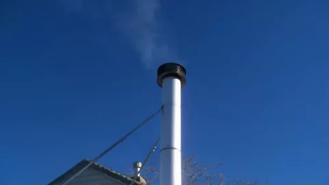

At 9500' the air is thin. Have you considered extending the flue a few feet to increase draft? Is this an option?
Could you use a small fan and "funnel" it into the secondary air inlet for a bit of a boost? A simple test like that could help figure out if a Drill modification could even help.
My installer hasn't mentioned it, and I think I probably can't safely go any higher given the winds I get, but it's something I will ask my installer about.

Adding a few feet to the flue will achieve this too. The chimney can and should be braced.

I hadn't even considered a temporary extension on the pipe, that's a great idea. I guess I'll have to pick some up so I can test this out as soon as conditions permit. Thanks for the idea.
