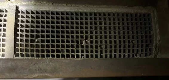

I installed the new cat last Monday (6 days ago). It seems to be working better than the cat I pulled out, but I think the cat I removed was essentially fine, and the new cat hasn't impacted any of my issues, unfortunately. I'm glad I did the swap regardless, as part of troubleshooting.

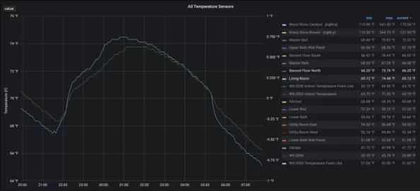

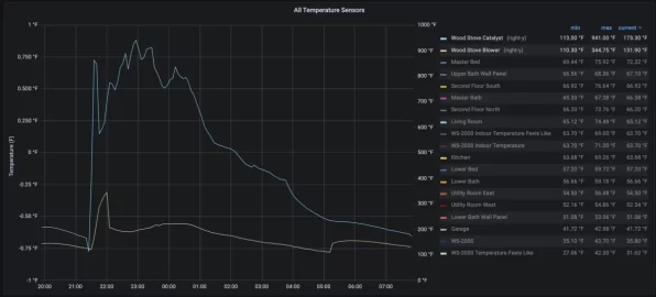

I had that working like a charm - I was super happy - for maybe 6 or 7 fires in a row. After step 6 there'd be hardly any smoke visible from the chimney, temps were great, and the glass stayed at least somewhat transparent for 2-3 hours before going opaque. But then I started running into issues where I couldn't get the cat warm enough to engage without getting pretty much the entire firebox going (which I know otherwise is what you'd expect), but then I'd be producing way too much smoke both in the firebox and out the chimney, which not only dirties up the glass and chimney, but keeps the temps cooler than I'd like. When this happens opening the intake more only makes it worse, and there's only so much better I can make it by turning the intake down, and it's still bad. This is essentially where the original question of "too much air?" came from. When thing are running really well, the cat will be somewhere between 800-1000 degrees for a few hours. When they are not going well (tons of smoke) it'll be in the range of 650-750 and for less time than when the temps are higher. Also when things are running well, the temp at my blower exhaust will be 220-250, and when they're not, it'll be 160-170 for a while, then raise to maybe a little over 200, then drop again. Everything is just way cooler.

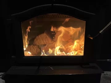

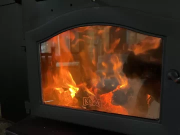

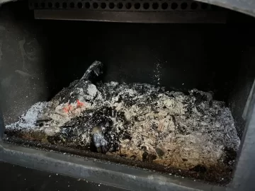

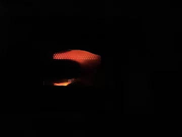

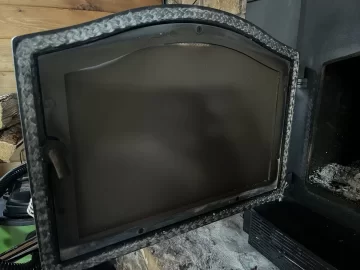

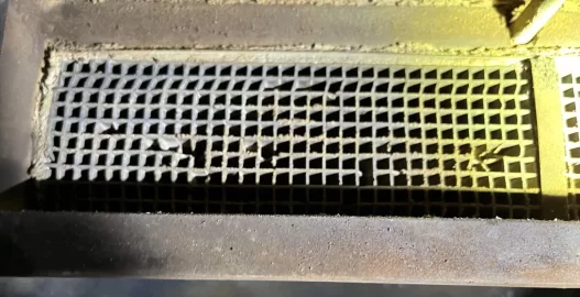

Just because I have them, I am attaching some video and pictures of how the firebox can appear to be burning well, but there's still tons of smoke pouring out of the chimney. The filenames explain the images. This is from this morning.
¯\_(ツ)_/¯
If anyone has any thoughts I continue to be all ears, but I realize this probably sounds crazy, like there's something obviously wrong with my methods or materials that you'd see if you were here, that I am not picking up on. I suspect that the opinion will be "bad wood".
