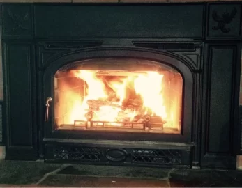

well so far so good
[Hearth.com] is it too warm out for a break in fire? [Hearth.com] is it too warm out for a break in fire?

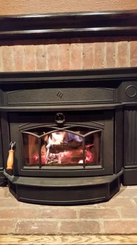

Mine early this morning. 40 at 5:30a

ohhhhhhhhhhh yeah, looking good, no draft issues do far.
just stepped up the fire a little bigger, smells like bad burning candles but tolerable so far.
I removed the face plate to watch for any issues. the entire unit appears to be steaming?very slight smoking? im hoping thats part of the paint burn off
  • [Hearth.com] is it too warm out for a break in fire?
Yep, that is the paint baking.
