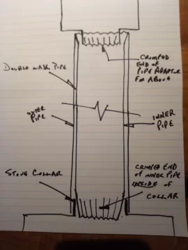

Testing now to see if an illustration will load.

Without an actual picture it’s difficult to say. It sounds like Selkirk DSP, the adaptor at the top is part of the chimney system and is not specific to the stove pipe. The stovetop adaptor is specific to your pipe. If the inner pipe is fitting over your flue collar then something’s missing.

Appears correct except if you are setting the lower double wall section completely outside of the stove collar. The pictured screw hole on the lower end of the lower pipe section should in theory attach the lower pipe section to the stove collar that should be sandwiched between the double wall. Do you need a stove pipe adaptor to accomplish this? Hate to see you have creo escaping onto the stove top instead of back down inside the stove collar into the stove.
It does not appear to be the same version of Selkirk DSP I am used to. It is similar. Your connection to the chimney adaptor at the ceiling should not be losing significant heat.

Doesn't seem to be any sandwiching. The whole thing is over the collar resting on the stove. No mess on the stove. (Hope I didn't just jinx it!)

I didn't think photos would be be any more helpful than an illustration.
webby It appears the entire pipe, inside & out fits completely over the collar & rests on the stove
Well, thats incorrect.

IF your pipe/install doesn't look something like the picture below, stop using the stove and get it sorted out now!

The joint at the top must be a snug, air tight fit, if not, it's drawing "cold" air from the room which could be condensing creosote just above the joint. The band at the top is just decorative.
