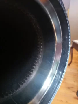

Well, without more pictures, I'm confused as hell. IF you have telescoping pipe, the end that you show at the stove top must have a male crimped end inside of that. Shut the stove down, give us a few more pictures of the tele pipe.

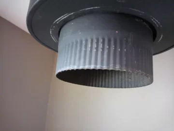

This picture is of the pipe adapter that comes out of my support box.

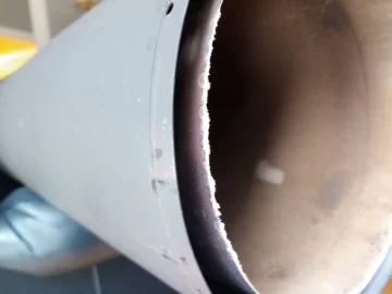

It is crimped. It is inserted INSIDE the upper female end of the telescoping pipe...
Shown in this picture...

The following picture is the male end. The inner pipe fits inside the stove collar. Like yours, the outer pipe is predrilled for attachment the stove collar.
[Hearth.com] Is my stovepipe installed correctly please?
And the female is above the male, held in place with 3 screws. The female is the only one with a crimped end & it's over the "crimped end of pipe adapter"
If this statement is true, your stove pipe is installed correctly. I also saw in the first picture that you posted of the tele pipe, the upper outside pipe is of a larger dimension and slips over the smaller, lower pipe section, just like mine.

I don't understand how the pipe at the stove doesn't have an inner wall that fits inside the stove collar. If it doesn't, and you're having the creosote issues that you mentioned earlier, that's a problem and I would stop using the stove now. Sorry, without more pictures of your setup, ie. the stove pipe removed and a couple of pics of each end to help you further.

That top pipe has a crimped end which is butted up against the support box, not IN it. It's not double wall at the crimp. [see photo in the other thread] It's pushed up farther now but still not IN the support box.
1. Is it too thin there to insulate the heat up there?
Should that pipe be wedged IN BETWEEN the support box & pipe adapter up at the ceiling or
2. is butted up against (not IN) the support box OK?
The silver adaptor coming out of the ceiling only sticks out about 1 1/2 inches... (I think that 3 1/2 centimeters)
3. Should that silver adaptor be extended to insulate better up there under the support box?
4. Do all the holes in the pipe (only through outer wall) make for too much heat loss in the pipe?
That sounds like the DuraVent DVL adapter. If so, and it is crimped, then someone didn't know what they were doing. If you look at the stove pipe head on from what is now the stove end, is there a series of holes around the inner perimeter?
Problem is that doesn't look like a DuraVent ceiling support box. Has me wondering if someone tried adapting this.
