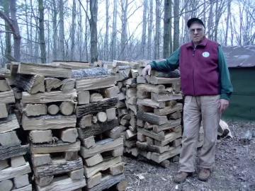

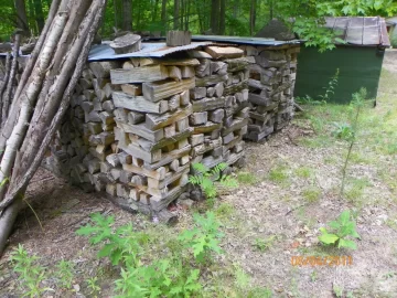

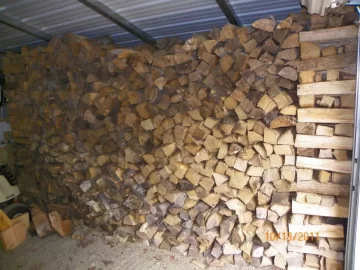

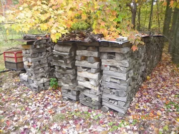

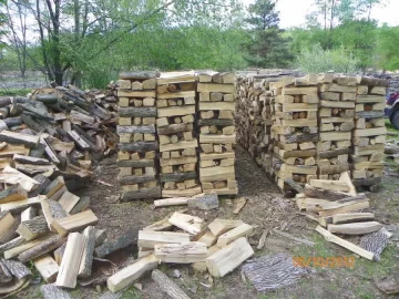

That being said, here is how we stack wood.
[Hearth.com] Is One Year Enough [Hearth.com] Is One Year Enough [Hearth.com] Is One Year Enough [Hearth.com] Is One Year Enough [Hearth.com] Is One Year Enough [Hearth.com] Is One Year Enough
Notice under the wood are some saplings we cut in the woods. We cut them usually at 10' then stack the wood on them. Top cover usually around December 1. Please excuse that tired old man in the second picture. That last picture is wood we move to the barn in October and that is what we burn that winter.

I am in process of restacking. Since I split manually the splits turn out to be oddly shaped and in wedges. Is it necessary to stack like salvage does criss crossing or can I just stack them? If I can stack them do I stack them loosely but I thought to determine how many cords you have you want them tight no? Also, I am going to do two rows on a pallet with about 8 inches of space in the middle?
In the pics is the criss cross pattern just for the ends also is the two rows with air space good for my setup?
Those are Cribs - or "end Cribs" or many other not so technical stacking names and used to keep the ends up. A good technique to know and utilize but fence posts, trees, whatever holds a stack in place, etc.. work fine too.
