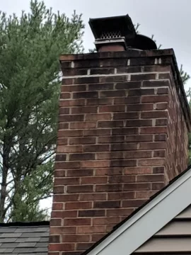

Brick exterior chimney. IMG_20181003_131948.jpg I am going to the town hall tomorrow to try to get more info on this 30 year old fireplace, if it exists. We didn't build the house so I don't know the brand and neither the chimney sweep or hearth store tech recognized it. The hearth store tech is the one who told it was a zero clearance fireplace. (I have more reading to do to find out what that means).
Also going to get a level 2 inspection (learned about that from reading the info on this site). Will be using a certified chimney sweep in RI. The damper size is 4 inches and the flue on the bottom is 5-1/2 rectangular.

Looks like there are multiple flues in that chimney.

That is definitely a zc unit but it is very odd that it is in a mulit flue masonry chimney
