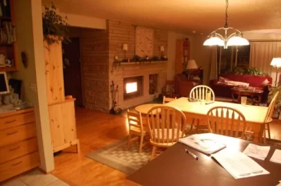

Hello Saul, I am a Morso 5660 owner near Olympia, and most of the time, I absolutely love it. Depending on how open your floor plan is, this insert will heat 850 sq. feet no problem. I got the standard (no blower), and it heats up the area it's in pretty quickly. It's in a large living room/dining room, with a kitchen, partially separated only by a counter. There's also a wide hallway leading to the entranceway and the small hallway back to the bedrooms. The large open area is about 20' x 40'. It's a 1960 house, remodeled to remove a bunch of walls, but poorly insulated (it's on the list...). The room has a slider and lots of large windows. When we put up thick curtains, it made a real difference in how fast and easy it was to heat. Anyhow, generally, I burn from afternoon through about midnight, and the gas heat does not come on when I'm burning, unless I've just started, the curtains are open, and it's very cold outside. The back bedrooms stay cool.
Last year during the ice storm we had 4 days or so without power, so I burned 24/7, and found that it actually heated the bedrooms, too. We were quite cozy. I think the hearth heats up when the fire stays burning for that long, and so the whole house gets warm (except the downstairs of course).
Other things to know about it: The bricks are fragile, and getting new ones is expensive and takes a long time. The damper is hard to adjust.
We didn't like the look of the surround, so we installed it without. I like it the way it is now, but my wife wants some kind of surround, so I'm planning on something custom to go between the stove and the bricks, not over the bricks, but to them. It's hard to explain, but I made one out of cardboard as a test, I just need to find a shop to make it for me. I'll post a couple pictures for you.

Thanks for the firsthand input GIW! Your setup looks nice! I really like the clean lines of the non-blower model. How do you have it elevated in your fireplace? Your idea about having a custom surround makes me think it might work in my application as well. I could recess it into my fireplace so that it's in line with the 1" tiles that line the inside perimeter of the fireplace and then have a custom surround built around it. Are you thinking a custom metal surround, or something like tile or stucco?
Thanks. It's elevated by 4 patio bricks I had lying around. Also, the insert has 4 built in levelers that you can use to get it just right. I think a custom surround would like nicer with your fireplace, too. The factory surround looks okay if you're building the hearth with it in mind, but for existing fireplaces, it seems too big to me. I was thinking of using metal, and trying to match the color of the insert. I will probably aim for something that allows air to pass through, something subtly decorative, and that I can reach a finger into, so it doesn't need handles, and I can take it out easily if I need to.
