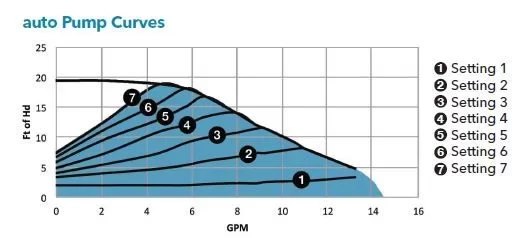

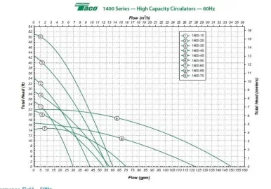

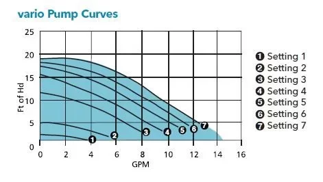

I don't have a horse in this race, I think, but here are the pump curves for the Taco and my Vario and an Auto and the Grundfos. The Taco definititely is most capable.

I am moving water from my shop where boiler and storage are located to my house, 140 ft apart. This was the pump recommended by the dealer for the loop, - which includes 280 ft of pex and all of the fittings etc -. in order to move the BTU's required. I am thinking I need to go back and look at all of the calculations to see if a smaller circ will work; however, this pump has easily maintained a delta t of 20* on the worst days of winter - even worse than design days.
I will dig out the calcs and post the numbers here - that should help with the decision. I seem to recall that head was calculated at close to 20 ft, and at the time the 1400 series was the economical choice for the installation.

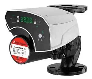

Hey, check this out!
http://bellgossett.com/pumps-circulators/large-wet-rotor/ecocirc-xl/
[Hearth.com] Is there a high capacity 'smart pump'?
Features
Control Modes
Proportional Pressure curve (Δp-v)
Constant Pressure curve (Δp-c)
Constant Speed curve
Automatic Night Set Back
Temperature Control Modes
T-Constant Control ΔT-Constant Control Δp-T (Paired with proportional or constant pressure mode)
Δp-ΔT (Paired with proportional or constant pressure mode)
Readings and settings on the pump
Control and display panel
Operating status
Warning and alarm
Errors and work log history
Dry running detection
Input/Output
2 x analog inputs (0-10V / 4-20mA)
1 x external temperature sensor input
1 x start/stop input
1 x status output
Communication and monitoring
Communication with BMS
Communication with PC/Laptop
Wireless module for short range wireless communication (optional)
Communicates Clearly
A simplified, user-friendly status display keeps the
installer informed on pump settings and performance. Communicate with Modbus and BACnet systems, or
use wireless connectivity to communicate with the
pump for remote control from your smart phone or
wireless enabled device.
I wonder does it have reverse acting capability with the temperature set point mode??? I have a call in to check this....

If it gets right down to the real world . I have all 3 of the most common eco pumps ,bumble bee , alpha , and the vario . The vario definitely wins the battle in output cababilities and is now my main pump . If at all you can make it work and are replaceing a pump, the new ecm pumps are worth it . My electric bill has dropped between 10 - 15 bucks amonth by using ecm pumps , and that has been now for three consecutive months .
