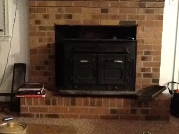

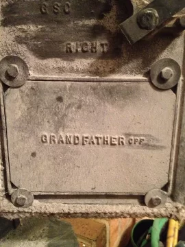

Looks like a buck stove but the window insert in the doors go sideways,(all pics I've seen are opposite.), and inside door say grandfather?

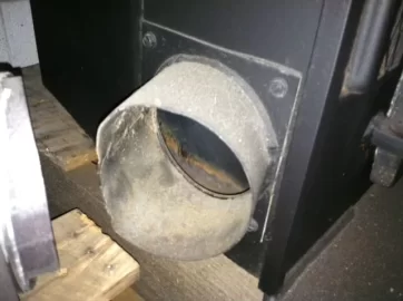

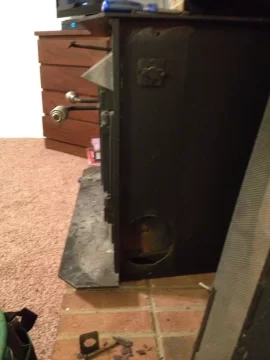

I need fan motors, blades, wiring and switches. The 2 holes in the sides for the fans are 5" round.
I have 2 5"holes on each side. I hope I can use this as an insert when I get the fans in and wired.[Hearth.com] Is this a buck stove?  I need parts.
I need 2 blowers that will mount on the side of my wood stove. There are 2 5" holes in each side for the fans. Any ideas where I can find them?
Thats the closest I've seen to an old buck that isn't. Looks like some frenkenstien buck!

The original configuration on this stove had a separate blower box (hearth blower) that housed the blower assembly and the electrical components (switch, rheostat). The box was connected to the stove by a flexible aluminum duct (4"). The hole on your stove would have had a fitting like the one on the picture below. You can mount the blower directly to the stove without the fitting, but it will stick out quite a bit and you may have to close off the parts of the hole that stick out past the blower snout. Good luck with whatever you do![Hearth.com] Is this a buck stove?  I need parts.
