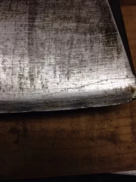

Is this a crack in my Fiskars X27?

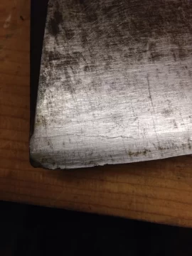

Hi everyone: I noticed this flaw that looks like a crack in the head of my ax. I can't feel it with a fingernail but it is visible on both sides. Should I stop using it? Should I contact Fiskars? [Hearth.com] Is this a crack in my Fiskars X27?[Hearth.com] Is this a crack in my Fiskars X27?
Can't tell what kind of damage if any that is.They warrantied one for me due to a chip in the blade. All done by email. Looks like you've gotten some use outta that one but if you do decide to contact them I can tell you they were very good about it.
In my last career I used to be a c.g.s.b. and s.n.t. welding and metallurgical inspector That definitely looks like a couple of cracks. The one looks more defined than the other. Do they show on the other side at all. As well you could take a magnet and some iron filings and do a home grade magnetic particle inspection
Sorry just re read ya that both sides not top and bottom of edge. Almost certainly a crack then. But again like I said your could do your own magnetic particle or penetrant dye inspection more often than not the crack goes further than you can visually see
Could've been caused by a defect in the rough material. Would need to know more about their manufacturing process. Ie. cast,forged,machining,grade of steel used, heat treating or hardening process etc.
Maybe a factory defect? Sure looks like it flares out abnormally to the outside as well.
Its a crack. My guess is that by the sounds of their customer support you will get a replacement. I would also guess that eventually it will actually break off that corner.
I put in a warranty claim this morning. The auto email from Fiskars said that unless they have a a follow up question I will receive a replacement in 12 - 15 business days.

I got home from work tonight and guess what, my new replacement X27 was waiting for me. What a standup company Fiskars is.
Did you have to send the cracked one to them?
No. I think I will destroy it so no one gets hurt. Maybe make a pickaroon out of it.

Never gamble with anything that looks like a crack. If you think it may be a crack, treat it as such, contact them and get a new one sent out.
