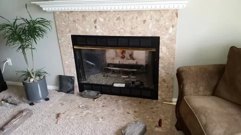

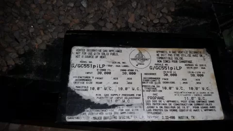

We bought our home in 2012 and it has a fireplace in living room which we have never used. We don't have manual and don't know how to operate. The fireplace is Model Number G/GC551piLP made by Majco Building Specialties. The house was built in 1995 and I assume the fireplace was purchased at that time.
Here are my questions:
1. Does anyone know where I could get a manual for this fireplace? We have searched the internet but don't see anything with this model number or anything even close.

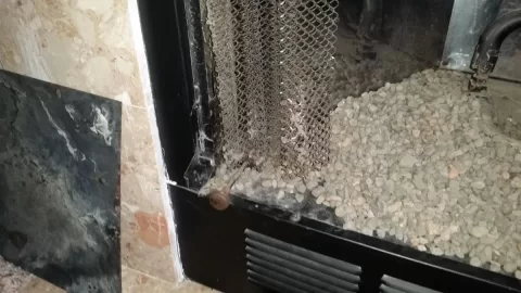

2. Is it a direct vent or is it a B-vent design? It has a non-opening glass front. Across bottom of glass is about a 1 inch opening into living room which would seem to indicate B-venting. The chimney piping is twin-wall pipe which would seem to imply direct vent.

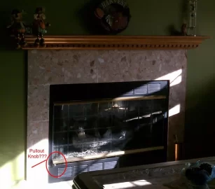

3. What is the purpose of round knob at lower left front of fireplace. It pulls in and out and seems to act like a flue damper but when looking up chimney there isn't a damper. I'm guessing that it is opening and closing the direct venting allowing the fireplace to act as a direct vented or B-vented fireplace? Just can't understand.
4. There aren't any on/off controls on wall or a remote control. There is a gas valve in the floor to the right of the fireplace and a piezoelectric ignition button. Not sure how I would start fire?
Thanks..Any help would be appreciated.
Bob

Based on what it says in the upper left hand corner of the rating plate/label;
" Not a Source of Heat," I wouldn't use it.
That statement alone says "You are wasting your gas $$$."
Shut the gas off & find a DV unit to install & get yourself a viable heatsource.
It's an older Majestic unit. With the open space to the combustion chamber, it's definitely a B vent model. I don't understand the coaxial vent system.

We found:
1. Pilot light/gas valve control (located under firebox through an access panel)
2. RS/On/Off rocker switch (it was small black rocker near front glass)
3. The small round knob at front of fireplace does open and close a door internal to fireplace
4. On the left and right side of fireplace (behind the glass) are 2 vertical slots which look like vent openings. Looking through this slot just above the round knob is where I can spy the internal door opening and closing with operation of the round knob control.

This is what I have learned:
1. This is a B vent fireplace. My comment above that I had a direct vent chimney was incorrect. I have a B vent chimney.
2. The knob on left side of fireplace is a damper to let in fresh outside air if desired. It was an option on this fireplace. However; I have discovered it was never plumbed to outside air. So I should always keep it closed.
