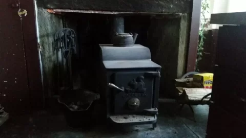

I'm thinking of putting an offer in on a house, and this wood burning stove is in the basement, obviously put inside a fireplace. Someone thought it may be a Fisher stove, but I'd like to get some expert opinions on it if I could. This is the only and best screen capture that I can get from the video I took as I walked around the house. Any info on the make and model of this would be great! Thanks in advance,

Nooe not a fisher and pretty sure it is an unsafe install.
Any idea who it's made by? What part of the install makes it "unsafe"?

Not enough floor protection. And i would det that is just stove pipe stuffed into the firebox maybe into the damper. But it should have a full stanless liner.
No idea on the maker but it really doesnt matter unless it has a ul tag
I have owned a few of these wood stoves over the years to recondition.... also known as the WOODLAND brand made around the 80's.
Possibly i think is Minnesota made , definitely a Fisher clone..

I question the contention that this sort of install is not "legal". It may have been perfectly legal at one point to run a pipe into the steelplate with no direct connection to the chimney. Probably is not legal now but that is bargaining point with the seller. Our family had a very similar setup in the mid seventies into the eighties which had the stove bolted to the plate and it came that way from the factory. It was a "legal" install at the time. It was bear to get going if the chimney was cold and creosote would coat the insides of the fireplace but it worked well enough to make a big dent in a heating bill. I do agree that the side and front clearances to the floor look marginal.
It comes down to the question, would I want to burn it the way it is?. I would not but if it was choice of no heat or wood heat due to a winter power loss I would chance it. I believe it can be made legal by putting in appropriate floor shielding, pulling the plate and direct connecting it but if it doesn't have a rating tag it may be moot issue as most insurance companies will not allow it.

My concern is much less about the legality of it than the safety

X2 on the safety concern, not the legality.
I have a woodland stove I bought new in 1980. They were made in Iowa. Mine has a glass insert on one door. I’m still using it I have some original info on it somewhere. Email me snd I can text or mail a copy or pic. Bruce
