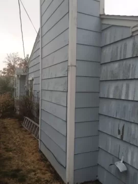

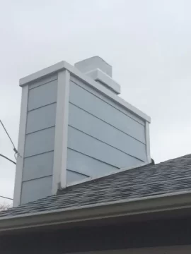

Well I bought the stove and now I am trying to figure all the pipe needed. I know I need 15' of chimney but is that measured from the floor the stove is sitting on or from the top of the stove? I will have 5' from stove to ceiling that will be double wall then into class A. My chimney chase is 15' floor level to top, if I measure from top of stove I need to have 3' of class A sticking out of the top of the chase. Not a big deal just want to make sure I do this right and the stove works like a champ.
. [Hearth.com] Is this an englander Madison  Model #: 50-SHSSW01 [Hearth.com] Is this an englander Madison  Model #: 50-SHSSW01
.View attachment 166805 View attachment 166806
I think it's from the flue collar.
