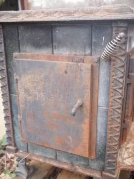

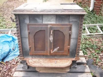

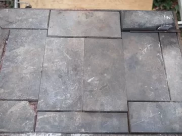

It's going for $100. Here's the pics

Looks like they used it as a huge flower pot. I'm assuming that's the vent although the shape is kind of weird.
that depends on how much of your time you are willing to spend. that is going to have to be taken down to the last bolt. by the look of that stove you will be drilling out the rusty bolts that break. then before assembly all the stones need to be buffed. lots of work. but you could have it ready for next year. i would love to know what model it is. it's to big to be a 3 and it is bigger than my 2 and i thought the 1 didn't have a secondary air tube.
The guy said it was either a I or II.
my 2 has a single door on the front. measure from the side door how long a piece of wood it will take. mine will take up 18 inch splits. the H 1 will take 24 inch

You can almost scrap it for that. If you want to spend some money on parts and a few days swearing at soapstone and cast, Id say its well worth it. If I needed a stove and couldn't afford a new one, I'd buy it in a heartbeat. It's a very fun and satisfying project, rebuilding a stove, if not done under duress

that hole in the fireback is because they never cleaned out the ash behind that back plate. common on these hearthstones. if overfired the top baffle (the curved plate at the top of the fire box) is usually melted or sagging. as far as heating capability my manual says if it is a h2 it heats 10,000 cu. ft. and if it is a h1 24,000 cu.ft. that stove that you have pictured has a secondary burn. it's the pipe with the holes in it. does it have a ash pan on the bottom? i ask because i don't see where the fire would get it's primary air. on my h2 the air comes into the back of the stove and into the ash area and there is a grate at the bottom of the firebox to keep the ash pan area clear for the air and i don't see a grate in that stove or a area for primary air. to price out what you need go to (broken link removed)
