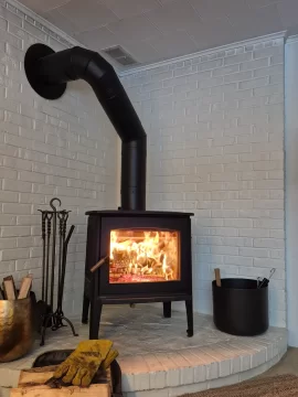

I'm glad you're not having problems with yours. It's definitely a draft issue with mine. After the problems I had with it the first winter, I had a chimney liner installed and only used kiln dried wood. Second winter it was still problematic and after last and third winter, I decided it was just the wrong stove for my house. It's in the walk out basement and the white walls and ceiling have been discolored by smoke and it leaves a layer of fly ash on every surface. I'm replacing it with a Jotul Oslo. Not my first choice esthetically but it gets good reviews for reliability and drafting. Despite the headaches, I'll be sad to see the Hipster go as its a beautiful looking stove and a dream when it works.

Maxikat, the issue in this case may not be the stove, but instead might be negative room pressure combined with a colder exterior chimney. If so, the Oslo probably will not perform better.
Have you tried opening a exterior door or window an inch, temporarily, to see if it improves combustion?

Thanks for your thoughts, but I've done everything. I've watched videos, scoured the internet for solutions and I've been in frequent communication with the vendor to try to troubleshoot the issues. I've opened doors, warmed the chimney, left the stove door slightly ajar until the fire was established and cleaned the baffles every few days. I even stopped engaging the catalyst because it deprived the fire of air. The Hipster replaced an old parlor stove that drafted perfectly but was a fire hazard. I'm just praying that the Oslo won't have problems🙏.

That's not quite right. The problem is weak draft, not the stove. The cat required stronger draft which evidently is not present. The Jotul 500 is now also catalytic. I have a feeling it's not going to solve this issue. This may take an easier breathing stove with a deeper firebox and/or a taller flue.
I'll have a meltdown if the Jotul has the same problem! This has been an all consuming problem and I really don't want to spend another winter complaining about my wood stove. I just want to sit in front of it and relax. The vendor has been fantastic and he's been working with me to select a replacement. He's confident that the Jotul is a good match for my set up🤞. Don't know what I'll do if it's a dud... it's too heavy to throw out the window! Maybe throwing money at a taller flue might be the fix. Time will tell. Wish me luck!
Keep us posted. I hope I'm wrong, but basement installs with cold outside chimney can be a problem. Some stove manuals explicitly call this out.
That's a nice hearth! I have just concrete walls and floors here. To the point of cracking a door or window - I have a slider to the outside about 10 feet from my stove. I open this when lighting a cold stove which helps with that negative pressure. If I have a strong fire, I won't open that door on reloads. But if my stove is dwindling, yes I do crack that door and it reduces the smoke and ash back into the room.
