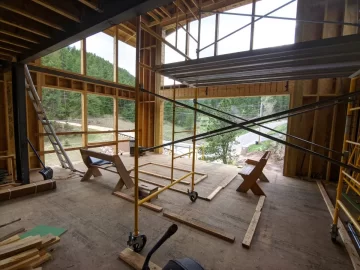

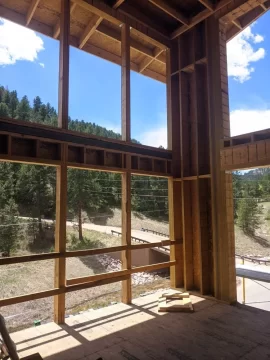

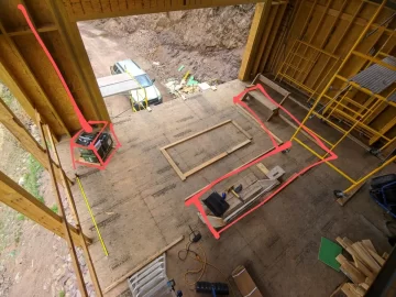

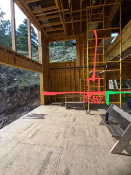

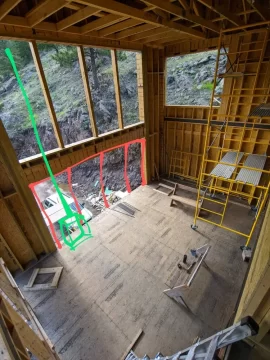

Here are some photos, with options of where the stove can be. (that large opening is a 4 pane patio door out to a concrete deck still to be poured).
