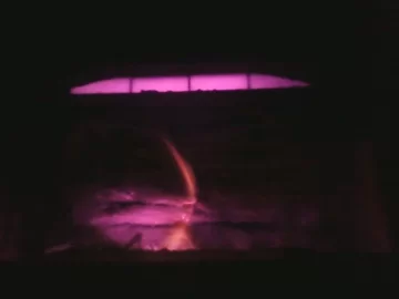

Is this typical for catalytic stove?
If so, I could live with that: cranked down to .5 during the day and overnights, open it up to setting 1 or more in the evening when we want to view the fire show.
On a cat stove : yes
On a hybrid stove : no
So why do the cat stoves keep getting a bad rap for poor fire view? That view is pretty awesome.
So to get a cat flame show to look like a non-cat, just allow more air?
And then the rate of wood consumption/heat output would be the same for both stove types when operating in this range?
Once mine is up to temp, I reduce the air all the way. It will run on nearly all cat with occasional flare ups. I don't get BK burn times, but their not bad.

"Slow Motion Explosion" flames, my favorite. Mesmerizing. Nothing constant to get bored of. I can't stop staring, waiting to see what happens next. I often get a constant ribbon of flame the full width of the window, across the top 1/4 of the glass. They are entertaining, but not my favorite. The air wash system introduces preheated fresh air into the top of the firebox that mixes with the smoke and burns it. Sound familiar?
