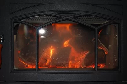

If you have the Hampton 300, it should be 2.3 cubic feet. I have the HI300 and it's the same stove but just an insert. When I fill it up, I go N/S with three large splits on the bottom, two smaller splits on top of the bottom three, and then little splits to fill the voids. Load this box up, get her ripping, close the air slowly over time and you'll get the overnight burns.
This pic isn't the clearest, but it shows an example how I can stuff the box.

Heck - your only loading 1/3 of a load. I get 6 bigger splits or 8 medium splits in mine for the overnite load. Don't be afraid to pack that sucker full. It is a very controlable stove.

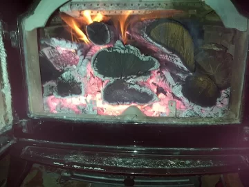

I'm trying the north/south method with shorter splits. How this look?
The five gallon bucket reference made understanding size and dimensions very easy. Thank you for the insight, Maxed_Out!

Mt, good pic that looks excellent. You getting good heat from that? The only thing I do diff is..... bottom layer is the same, then longer splits e-w. I dont think it would change anything. By my ests Jags loads are double mine and thats fine. There are some nights where I do go to 50lbs but they are few and far between here in south central PA.

It's running around 650 right now with good heat. Temperatures will only drop to the mid 20's tonight, therefore, keeping the house warm with both stoves isn't too bad. It's 78 degrees at our HVAC thermostat right now.
