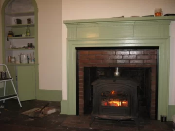

Hey Jags; I just can't seem to decide between these 3 stoves, unfortunately my fireplace opening is only 30.25". The Manchester is the best fit because the top of the flue pipe on the Manchester is 28.75" so this gives me 1.5" of clearance, the top of the flue pipe on Isle Royale is 29.75[.75" clearance] and on the F600 it is 30.5"[I would have to grind out the underside of the brick to make room]. I have about 22' of 6" flex liner with 2 floors [1800sqft] of somewhat drafty house to heat. The Manchester makes the most sense but I'm not in love with it's looks, I do love the look of the F600 but altering my fireplace doesn't appeal to me. The Isle Royale is another beauty and the n/s loading option is great but I worry based on what others have said that I won't be able to control the burn well enough. I know you run yours hot but could you run it at 500 with full loads if you wanted to. Here is picture of my set up, I'm a little worried about too much heat build up around the mantel area and behind the plaster wall.

With 22' of liner it is gonna draw pretty hard. It is a very controllable stove meaning that overfires and the like are not an issue, but much like many other stoves, it has a sweet spot that they like to cruise in. The IR likes somewhere around 600 (much like the Englander NC 30).
Keep in mind that the 22" length of firewood that is advertised for this stove is E/W. If you are gonna burn N/S your wood will need to be shorter than that.
