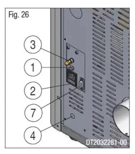

Hey sorry I tough I had answer to this post. One thing that could be causing this, in the back of your stove showed by number 3 in this figure there is supposed to be a cooper cap nut make sure it in place and hand tight properly If not in place, the pressure switch that is also connected to the hopper and the auger will send alarm to go on, it depressurise the pressure switch specially if it's an used stove they might have tried to set it up and forgot to put that screw back in place. if not and still having problem message me.
The cap is on and hand tight. I did just purchase a magnehelic gauge online so will get it next week sometime and be able to get some pressure readings. I know in the manual it states alf2 message is related to pressure and I am getting alf1 reading. The stove is a new one by the way. I am currently away and get home mid week next week and hoping I plug it back in and it works but probably wishful thinking. Thanks for the reply and Im sure Ill have more Questions for you. Happy Thanksgiving.

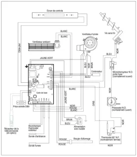

if cold test end out to be good on all components then everything is pointing to that hopper switch and related. These stove travel a long way to America and I have seen once loosen cable on mother board.
Because your saying that you did bypass the hopper switch by connecting bot wire together,
can you now double check to see if all cable are in place with the diagram I attached you below
if they are... I would,,, one by one, unplug the cable related to the hopper switch, to the pressure switch,
and use an oms meter to check them individually, this procedure will take a few hours need to take the grid and tree covers of, gee I which I'd there to help you.
if everything seams ok, let me know how tings goes

sorry for the french version but you can have this Monia Diagram in your owners manual
Thanks again. Everything ok with the cold test although during test the alf1 reading appears along with test. I've checked the wiring just by eye as well as I can see no loose connections. My next move will have to be a test on wires but I have to get a meter. I think I have one around somewhere. By the way I also hotwired the wires to the pressure swith thinking that might be a problem but no change. On an unrelated note I disconnected the hose going to the pressure switch not taking note that there is 2ports. Could you let me know what port it attaches to. The one to the back of the stove or th one to the front. Thanks. I'll be in Florida this week so no stove needed but I could be desperate when I get back.
