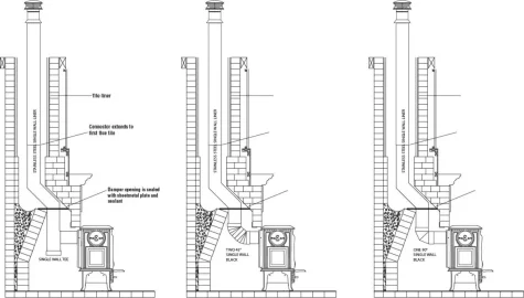

I will be installing a Jøtul 3 into an existing masonry chimney over the summer. The stove is set up to vent out of the back. My question is do I use a tee with a clean out, a 90° or two 45°'s to make the first turn up? I am going to run stainless steel single wall up the entire length of the chimney. I think this will give me a better draft and be easier to clean. Does running a tee with clean out screw up the draw at all? Also when I get to the top of the chimney with the stainless pipe do I run it a little long then cap it then put a cover over the open terra-cotta liner?

I just had this done at my house with the same stove. We used a tee with cleanout on the bottom and the s/s liner exits the top of the chimney and over that and the clay flue sits a cap to prevent rain, or whatever from going into the flue tile.
We had a length of about 20' from stove to top of chimney and we have no problem with draft.
Use a T. Always.
The liner needs to come out of the top plate enough to be clamped and a storm collar installed. It should not rise any further than necessary for the collar or cap to be placed as it will be the coldest part of the flue and have the most creosote build up. Usually.
