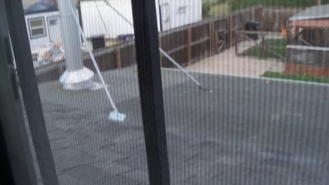

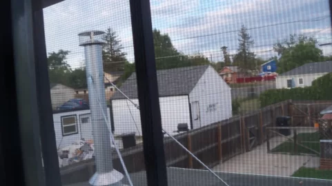

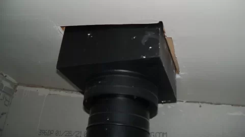

There are some questions about my stove connection that I want to ask and I took pictures to the best of my ability especially the ones coming from the attic window with a bar going through the middle of it. Now inside I have a box on the ceiling with a frame that goes around it and the insulation in that area of the roof is regular pink insulation with the paper backing and it seems to go right up to that square box in the ceiling so I had them leave the framing of the box off for now..so that I can ask this question..Do I need to have special insulation in that area of the metal box ? My second question is from the outside chimney pipe does the installation look pretty good on what you can see--fuzzy picture I know..Just wondering about these things..clancey
