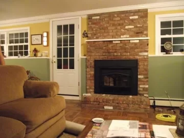

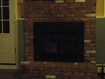

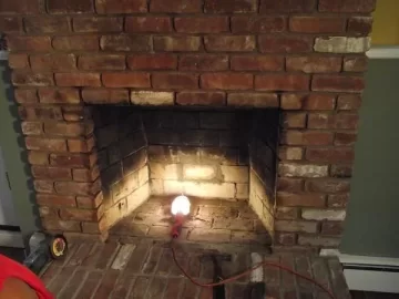

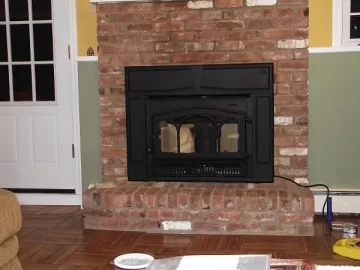

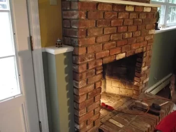

Jotul 550 is in. Bit of a PITA because the firebox floor is below the level of hearth by about an inch. Had to raise it up with slate and it caused some difficulties but I think it's all good in the end.
Put em' in backwards but you get the idea.

And you put that BigBoy in that little hole, good job looks greAT.
Yeah pretty close. Had to remove an outside air intake so it could be pushed in all the way. You can see the replacement brick in the center before the insert went in.
