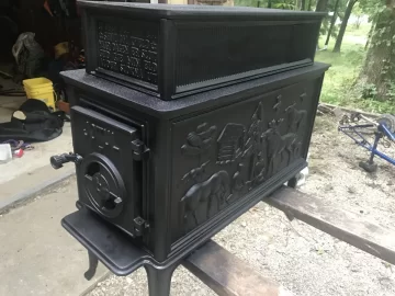

Looking real nice so far. I’ve fixed up several old Jotuls. My favorite was an old 606. My latest was a 118.
  • [Hearth.com] Jotul 118 - Restoration Questions
Nice. You don't come across many 606s.
