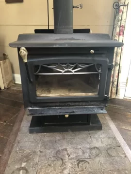

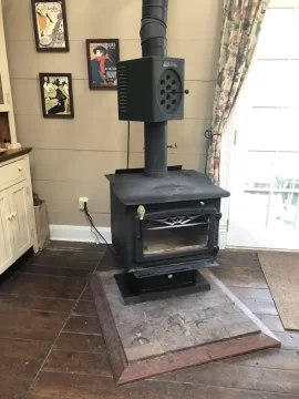

The freestanding stove was by CFM out of Mississauga, Ontario. Model FW300010, Certified EPA 1990. Here are a couple of photos. Installation included a Magic Heat, which was amazing!

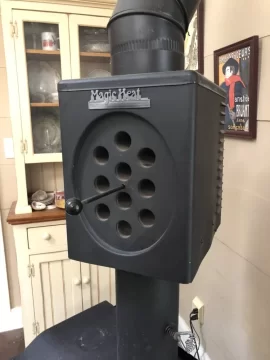

Magic Heat, a favorite around here! Get a Condar thermometer and stick it the vent a few inches back and mark it if you need to so you can read it (may need a pen light).
You want to confirm you can run it up to a good temp. When I'm cruising along it's uncomfortable to keep your hand in front of the vent. When really cranking you don't want to leave it for long at all.
Being a flush unit not saying it's the be all and end all of inserts but I'm able to get pretty good results. Just want you to get the most you can from it.
