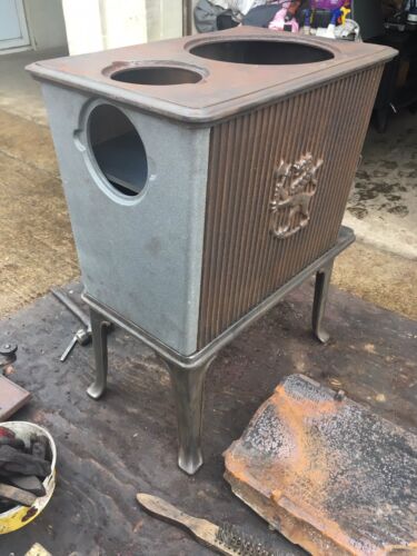

That's pretty bad. Replace the back. It's not that big of a deal on these small stoves. I did a full rebuild with a new back in about 3 hrs. and that included drilling out and retapping a couple of busted bolts.
To avoid this problem in the future, consider adding a rear heat shield inside the firebox.
Thanks. Yeah it's a big crack. I did read your post about adding a rear heat shield. I haven't seen any about replacing the whole back—I did not realize that was possible. Any resources you suggest?
All I had was the parts diagram. It's a simple stove. Put a ratchet strap around the stove body. Remove the top, then remove the side bolts to the base.

BTW, Some folks try to jamb in longer wood than the stove was designed for and in some cases knock it in so the door can shut. Definitely a very bad idea with hot cast iron (or cast iron in general.
The backs on these stoves can get very hot if overfired. Ours was overfired by a housesitter and cracked the new back :mad:
