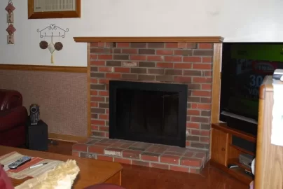

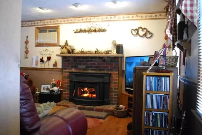

Ok, maybe this will clear things up here. Sometimes pictures help with explanation's.
Pic 1 - This is a raised hearth. It measures about 5.5 inches in height above the wood floor. It extends out 16.5" from the fireplace face.
Pic 2 - With the stove in, I needed to extend 18" out from the glass on the door. I only had about 10" out from glass door to end of raised hearth. I added a peice of brownstone to get to the 18" measurement. This is standard ember protection because the stove is not sitting on this stone. One benefit is the stone can be moved out after burn season!
The reason the passes code is due to the fact that the stove is sitting on a hearth that is more than 3.5" from a combustible surface. The key here is the "UNIT" is raised more than 3.5" from the bottom of the stove. I have 5.5" of brick hearth measured from the bottom of the stove to the floor so I could get away with "Standard ember floor protection".
The manual states "Thermal floor protection not required if unit is raised 3.5" min. measured from bottom of stove. At this point the standard ember floor protection will be required. It will need to be a non-combustible material that covers 16" (406 mm) to the front of the unit (in Canada 18" (450 mm) and 8" (200mm) to the sides.
All floor protection must be non-combustible (i.e.,metals, brick, stone, mineral fiber boards, etc.) Any organic materials (i.e. plastics, wood paper products, etc.) are combustible and must not be used. The floor protection specified includes some form of thermal designation such as R-value (thermal resistance) or k-factor (thermal conductivity)."
