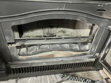

I've had the MK1 C550 for 6 years or so and I'm impressed. However, this season, I've noticed I don't achieve secondary burns. I swapped the door gasket with no improvement. Previously I would regularly see flames coming out of the burner tubes and I only burn seasoned wood. However, I'm sure I've found the culprit. The air manifold gasket is not secure. Therefore, I'm going to replace it this weekend and report back.
Does anyone know if I have to remove the baffles and tubes to remove the manifold? I'm hoping I can just remove the three 10-mm bolts from the inside of the firebox, without removing the baffles and tubes.

I have the 550 as well. I don’t know exactly how to adjust the manifold gasket, but it looks like the way the baffles are currently sitting is a little bit off, with the right one sitting a little higher than the left. Not sure if that is contributing but wanted to mention to help rule out everything.
Thank you @Ctwoodtick , I appreciate your observation. I checked this morning before loading up the wood and there is some play, so I'll thoroughly clean the area (& baffles) when I swap the gasket. The gasket has clearly dropped down on the left hand side of the manifold (it's visible in the photo), so I wonder if cold air is going straight up the flue, rather than being directed down the glass into the firebox. Air is being channeled down the glass and through the directing vent on the bottom of the grate center, because the wood burns bright in the center (opposite the exit of the direction vent).
I presume its the gasket which seals the manifold to the firebox and not the one which is affixed to the air intake slider. The c550 manual has a great diagram indicating the positions of the gaskets but there isn't clear instructions on how to remove the manifold.

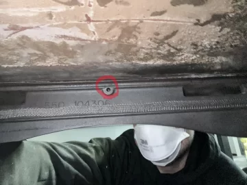

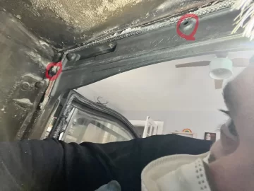

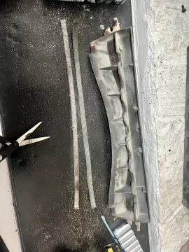

I wanted to circle back and share the full outcome in case this helps someone else running a Jøtul C550. For context, my wood supply was not the issue. I burn properly seasoned ash, oak, maple, and hickory that I’ve processed and stacked myself. Moisture content is consistently good, and this stove has produced strong secondary burns many times in the past.
This season I noticed the secondary burn had essentially disappeared. Early on, I removed the burn tubes and baffles, but they were surprisingly clean. I also replaced the door gasket at that time. While inspecting further, I noticed a gasket hanging down between the fins. After pulling the baffles and tubes again and inspecting the manifold area more closely, it became clear that the loose material corresponded to the inner air manifold gasket. My working theory was that this gasket was allowing excess intake air even when the slider was set to low, effectively over air feeding the stove and disrupting secondary combustion.
Although the perimeter manifold gasket looked intact, the flat gasket at the intake interface appeared compromised. I cleaned everything thoroughly, even though buildup was minimal, and replaced both air manifold gaskets.
The gaskets replaced were:
  1. Gasket, LD .250 SA Fiberglass Rope, Outer Air Manifold, part 129644
  2. Gasket, .125 x 8 mm Flat SA, Inner Air Manifold, part 127215
Removal was relatively straightforward. There are three 10 mm bolts securing the air manifold to the front. The middle bolt is longer than the two side bolts. During reinstallation, I installed the left bolt first and rested the manifold on it to help hold alignment. I then installed the right bolt near the air intake adjuster, and finally the longer center bolt. Tightening them evenly ensured a proper seal.
Since installing the new gaskets, the burn has been noticeably more efficient. Later that evening I began seeing secondary combustion again. It is not as dramatic as what I have seen previously when burning pine, but secondary burn is clearly visible, especially in the slower portions of the video. The stove is once again responsive to air control adjustments.
