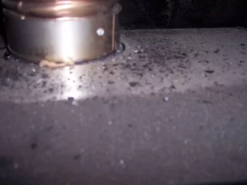

Thanks for your reply. I took my Mag light (unfortunately, its the brightest light I have), but was unable to find anything that would suggestI have a broken seam. I did however, spot this (see pic) After doing some general tapping, I believe I found the source of the noise, which appears to be the Stainless Steel Sheet that covers the flue. Unfortunately, I am not familiar with the exact term of this, but I believe this is some sort of Damper. Regardless, as you can see from the picture, I also have burnt material that is on top of this, which suggests that when the heat expandtion does occur, that its dropping this material on top of the fire box. I called my local vendor, who has recommended that I take the face off the box, and take some additional pictures to bring them into the shop. He also recommended I contact my chimney sweep to confirm there is no issue with the chimney itself.
As to the other questions - I have an external chimney, its two stories, which I believe is at least 20ft in height. My wood was at 18% MM, however I dont have it covered with anything better than a tarp, and I know that the moisture has to be higher due to some recent rain /snow we've experienced here in W. NY.

  • [Hearth.com] Jotul c550 Rockland tips thread
Final Follow up:
After discussing the pictures with my Vendor and Chimney Sweep - the general consensus is I am correct on my guess as to the source of the noise. As to where this Creosote is coming from, that is another question. The Chimney Sweep is under the impression that the material has been there since the day the unit was installed. When he does his sweep, its from the inside of the unit, thus, there is no need to remove the surround. There is also a chance that I *might* have a break in the chimney liner, although, that is most likely not the case since this is a two year old unit.
While I had the surround off, I also found that part of the insulation had been moved and /or never put in correctly. I have corrected this as well.
Unfortunately, I'll have to wait until my chimney is inspected before I begin attempting to burn in the upper 500's again. In the meantime, I've been cleared to have 400* fires as long as I'm home and its not overnight.
