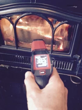

I don't know why my burns are so much cooler. Here is a photo taken about ten minutes after loading some new splits. I'll shoot another at a 15 minute later burn.

Stone, are you shooting the glass or the door? Stove top temps should be taken from the vent to compare with most others. I keep a magnetic thermo in the vent, center right about 3" back. Hard to get a good reading with my IR but have rough agreement between the two.
The glass, with the laser dot on glowing coals. The highest reading I can get in the top blower slot is about 300. I get about 350 pointed to the back, onto the stack. When I opened to add more wood just now, after running vent half closed, the metal floor was high 600's into low 700's with door wide open.

I was shocked by OhioBurner's IR reading of 699 pointed at the glass, with door closed. This is how I typically monitor my burn, and have never seen a number like that without opening the door & shooting at coals.

Various people have said the IR won't read correctly off the glass. I don't know how true that is but in any case I wouldn't worry too much about the temp of the fire itself or the coals. What's relevant and useful for comparing to others is the stove top. You don't want the top too much over 750 on any regular basis although once in a while won't break it. Actual glowing is the issue to be avoided. If you suspect over fire turn off the lights and look in the vent at the flue collar.
The vent I'm referring to is the air vent where hot air comes out. From there you can shoot the flue collar or try getting a reading a couple inches back. Not the easiest due to the angle but can be done. That's why many here just put a regular stove top thermo in the air vent and read that. I'm at 550 right about now, peaked at about 625 earlier.

Glass will read much lower. I think the glass reading is close to accurate, but with the air wash and all its not necessarily indicative of the stove. Short of having a remote stack probe or something, shooting the stove top through the vent is going to be best and what most of us here do.

What is the emissivity index you are using for that reading? Most IRs are set up to read a very dark or black surface, not a flame or reflective surface. Even a reading from the outside of a stainless pipe will be way off from actual temperature. I guarantee the actual temperature of that flame is over 570ºF since it is burning.

Emissivity is set to default 0.95 which should be pretty accurate for glass and painted steel. Also remember not all thermometers are equal. I've found quite a discrepancy between them. Even with IRs unless your going to spend >100$ on a pro one I wouldn't trust they are that accurate. I've noticed significant differences between them.
I have to be honest Oldman47, I don't have a clue. I bought that IR years ago to look for escaping heat from the ductwork in my attic. I never read the instructions other than a quick glance. I'll look into that.
Re OhioBurner. I missed the text under the photo with the 699 degree reading, and thought you got that reading at that location. My bad.

The glass has an IR coating on it to reflect heat back into the firebox, so im not sure what that does to the readings. In any case, put a magnetic thermo in the vent area
