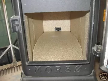

  19. precaud
    precaud
    Jan 20, 2006
    2,307
    45
    Sunny New Mexico
    See the attached pic, the Morso 2B has primary air at the bottom-rear too. Not as aggressive as the F118 but there nonetheless.
    The F602 has no primary or secondary air in the rear 1/3 of the firebox, and as a consequence there is no combustion back there. I've documented that pretty thoroughly here in my past F602 experiments.

    precaud, I can see from the picture what you mean. Burning the candle at both ends. I guess that makes it a N/S, S/N burn.
    I'm not a betting man, but I would wager more air surges through the door than in the back, just by looking at the path the air takes.
