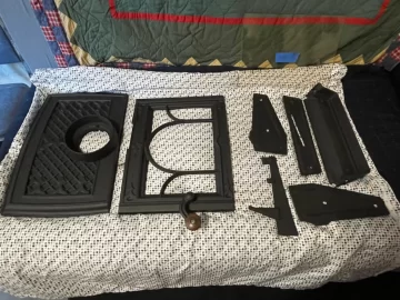

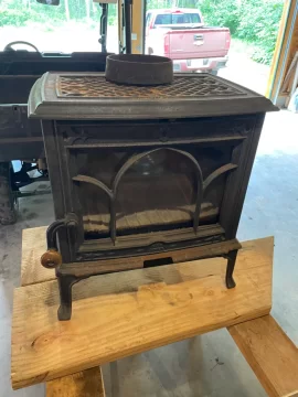

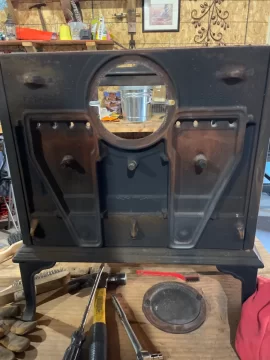

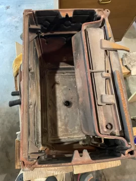

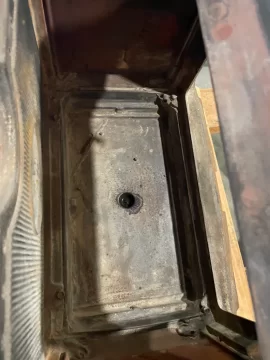

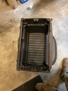

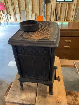

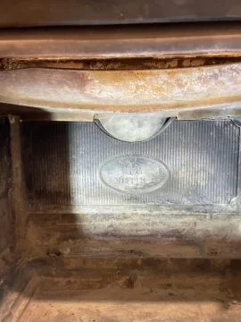

Picked this up today for $600. 2006 model. Needs a new baffle, it was a major pain getting it out! Had to cut a front corner off after removing the top. Everything else seems ok except all the gaskets need replacing. I’ll clean her up and give it some fresh paint then I’ll install her in my workshop this Fall and see how it burns compared to my 602 CB.

Looking forward to seeing the progress! That'll look good in the shop too, although it may be a sad day to see the 602 go!
Reactions: Turbo89
Looks like a fun project. I'll be interested to see what the verdict is. It's prettier, but i suspect you may be missing the 602 for longer split loads and burn time.
Reactions: bigealta

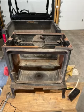

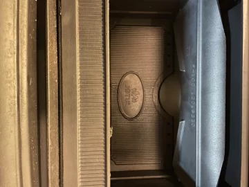

Yeah I don’t really want to part with the 602. Probably just swap them out to try the F100. After taking the primary air apart it looks like it totally sits the air closed, no EPA stop. The secondary air comes in the back in two small holes covered by plates. Burn times may be better than I was thinking.

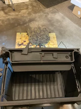

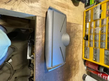

I have it all taken apart except the main base. The cement is still solid so I’ll leave it there and start prepping and painting. Also have to order a new baffle today, looks to be about $100.

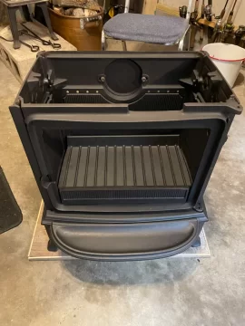

Everything is prepped and painted. Just need the baffle and gaskets to put it back together. The firebox side panels and bottom plate was a bugger to get back in place!

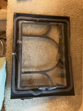

Yes indeed! I kinda like restoring these older stoves to their old glory. After taking this stove apart I really like how simple the design is. The box is cemented at the seams and bolted together. I’m surprised the cement is still solid after almost 20 years. Every bolt throughout is 10mm except the screws holding the glass. Every single one came out easy. Hardest part was removing the cement for the door gasket and fitting the firebox back together. I’m hoping the new baffle can easily be removed without removing the top.

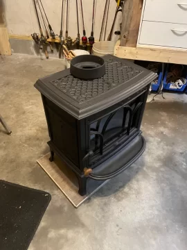

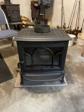

Put it all back together, just waiting on a new baffle.

I was going say that $600 more than I would have paid for it then i saw the the finished pictures and thought that was a decent deal.
Reactions: Todd
They were asking $900 and I offered $500 then we settled at $600. Used stoves seem to be priced pretty high around here. I bet I could get $1000 for it this fall but I may keep it and sell the 602, not sure yet.

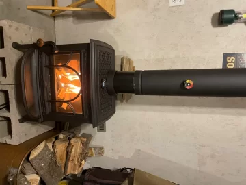

Small break in fire

Small break in fire
I can't believe you can have a fire today (even a small one). It's like a swamp here in NJ and been like that for a while. Only getting hotter tomorrow.
