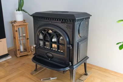

Hi everyone,
Thanks for all your messages!
I wasn't entirely sure if it was the right choice, but your messages helped me a lot and I bought it last Friday.
I paid $765 US, the seller made an impression of being nice and trustworthy.
Stove is used but in really good condition. Seller cleaned it inside and painted it with silver paint (colour is not really important, but it is good that the paint protects the elements from rust). Outside finish is the original blue black enamel.
I cleaned it from the outside yesterday and it looks really nice. I attached a few photos below.
Now I'm just wondering whether to paint the wooden door handle or not. Could I use regular wood paint or something resistant to high temperatures?
Once again, thank you very much!

Looks nice. The interior paint will be gone in a few loads. I would think.
Some stoves will eventually discolor wood door handles due to the heat.
Guessing the manufacturer left it unpainted on purpose. Dunno
Enjoy
Reactions: feeling7
It looks really good. Let us know how you like it after you start burning in it. About 16" splits (dry, well seasoned) should be just about right for that stove.
I would not paint the wood knob on the handle. The oils from your hand will help oil it over time.
