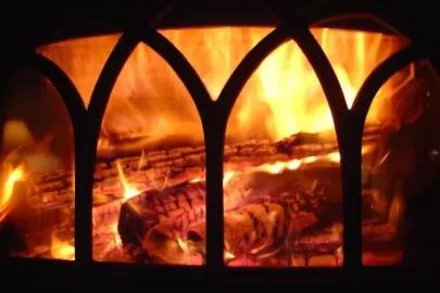

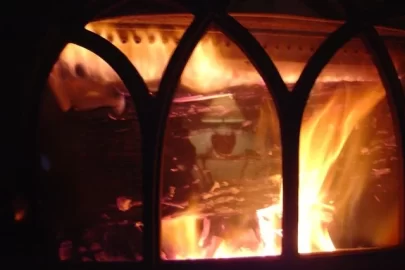

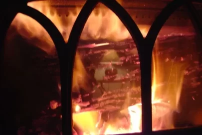

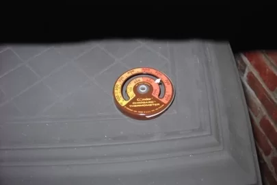

Here is what you get when you load the 1.75 cu. ft. firebox to the baffles with coals filling all the nooks and crannies - one hot box! I don't think I maintained the 1" gap to the glass. Oops.
