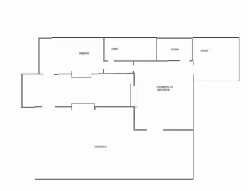

3)Heat distribution in the house (meaning first floor) - bear wit me please I will try and explain the set up as good as I can - I have a 250 year old Cape. The set up I believe is fairly traditional for this type of house, meaning a central chimney stack with three fireplaces. We have the Jotul in what used to be the kitchen and two rooms off that forming 2 sides of a rectangle (hope you are still with me) - the remaining side of the rectangle is the entrance door/hallway and stairs leading up. Off from what used to be the kitchen is today's kitchen.
Now i was hoping to use the wood stove to do the majority of the heating downstairs. room with the stove is smaller compared to the left which is the living room which is fairly sizable. I have bought door fans (as an interim measure) and intend to put in some wall fans on the floor for next year. Given the information that you have do you think it is realistic to heat downstairs wth what i have? Do you need more information. My wife keeps talking about buying a second stove for the other side (non living room side (which is a library/play room for the kids)? If I didn't make sense I apologize!

Also - what do you think about the idea about putting a smaller stove into the library? Would it appove overall heat distribution?
I tried to draw a layout of the room on visio but failed miserably, I am at work after all. I will try again with a very simple graphic.
Not sure if that helps, especially as on conversion to a picture file all the text got blurry. Not sure how this will look once posted. should it be garbage - apologies!
Now should it work - the room in the middle with 2 blurry lines is the stove room dining room. The room at the bottom (biggest room) is the living room. the room top right is the library, the room top left is the kitchen. in-between two small rooms: office & pantry.
