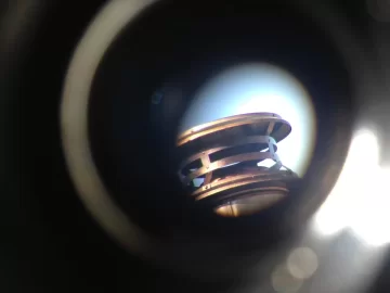

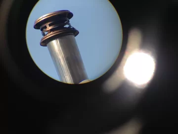

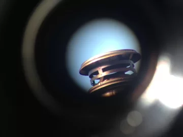

I popped the bottom plug off the chimney. A little bit of soot, but nothing indicative of any buildup. I did not yet climb onto the roof, but I took some pics of the chimey cap through my spotting scope. Looks like when they installed it, they removed the mesh spark arrestor. Certainly no buildup I can see. I also stuck my hand up on the insulation blanket at the top of the stove, I don't feel anything. Going to borrow a buddy's borescope tomorrow, just to be sure.

Condescension? Everyome is just giving you some of the most common problems that we have seen or experienced firsthand.
