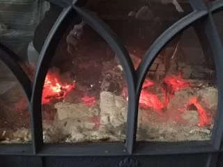

Hello all,
I have a relatively new, few months old, Jotul F500/Oslo. I bought it because everyone was saying how it would heat your whole home for cheap-er, plus, we just wanted the ambiance of a fireplace/stove.
The issues I'm having with this is that they boast 9 hour burn times. Currently, no matter how I stack it, or how I burn it, I'm looking at what I would call 3-4 hour burn times max. When I get up at 6am after filling it at 11pm or later, theres not even enough hot coals to relight it.
The wood is NOT the issue, I have excellent seasoned hardwoods, the guys from the store, and other wood burning people have said this is top quality hard oak, seasoned over a year.
I loaded it densely, with hard oak, I cross cross them etc, but still 3-4 hours burn time max. After 3-4 hours I was left with the below, it will only hold temps 400-550 for about 3 hours then drops. Cant quite figure it out but really disappointed with this stove, I seem to be loading it full way to often to enjoy.
The picture is whats left after 3 1/2 hours from being completely packed full.
It doesn't rage out of control, I cut it back (the air lever) as soon as I can, it doesn't go above 600F max, it just seems to be burning very inefficiently

Welcome. Try not criss-crossing the wood. Instead, pack it tightly with the wood parallel to the glass, all in one direction. Also, at what stove top temp is the stove being reloaded? How thick are the average splits that are being burned?
I'm wondering if the draft is excessive. How tall is the chimney system on this stove?

After 3 hours it looks pretty empty as per the photo in the thread.
By 3 hours temps have now come under 400F, they only stay up there at 500-600 for two hours MAX!
The lack of hot coals the next day at 6 or 7am, all gone to just ash from a full load at 11pm the night before.

How much are you shutting the air down, and are you getting good secondary combustion? Realistically, you're probably only going to get 4 hours of 400+.
Yes, I bring the temps up to 450-500 and shut it down 50% then wait a min or two then shut down again, then shut down to zero!
I think the door is the issue or the stove, if I didn't turn the air down the temps would go up over 600, I control it pretty well
Criss-crossing the wood adds a lot of air space to the fire. That will make it burn much faster. I would definitely add a key damper to the flue pipe to reduce draft strength. You can probably operate the stove with the key damper all the way closed once the fire is burning well. This will be more effective than the steel wool.

Are you getting flames from the secondary tubes, or off the wood?

I do see secondary arora borealis type flames bouncing around from tubes or wood? I don't know
Install a key (butterfly) damper. The chimney height is too tall.

What about the dollar bill test? I can pull it through the gasket when shut tight
They were wrong. Burning unseasoned wood or letting the stove smolder will build up creosote, not the key damper. You'll note that in your stove manual this is what Jotul recommends for tall chimney with strong draft.
Is there some resistance to the dollar bill or none at all?

As for the dollar bill there is pretty much no resistance on the side door, but I can't pull it through the front or ash door
