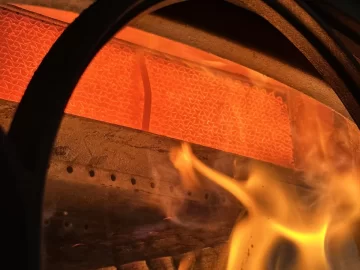

I noticed the chimney is smoking again, and in the top right corner my combustor… Is starting to disintegrate again. It’s hard to explain, but it’s like the combustor is starting to collapse on itself.

If you zoom in on the top right corner of the combustor, you will see it’s starting to come apart in the corner. When we had our combustor replaced last year, the combustor was falling down on both the left and the right corner. So far this time it’s the right corner only.

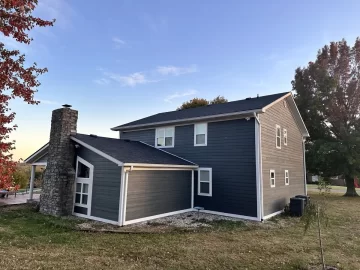

I want to answer some of your questions.
My chimney is around 15 ft tall I believe.
I am not using a liner, other than my 8x12 clay liner. I deliberately bought the JOTUL because it was one of the few stoves that said it could operate with an 8x12 chimney.
The stove drafts very well, and I’ve had zero problems with puff back.
It’s connected with double wall pipe.
I monitor all three temp gauges but mostly the top right gauge. I follow the manual and try to keep that around 600-650 degrees or 500 degrees if we’re just maintaining and coasting.
And yes I do notice the cage that holds the combuster is warping.

I haven’t seen one in person but your pic of the glowing cat doesn’t look like the Jotul high flow cat that I’ve seen pictures of? I thought the cells were much larger? Almost looks like a regular foil type steel cat?
It’s definitely this guy right here.

That's an expressive pic of a well lit cat! Guess there's no probe nearby to measure temp? I'm not a Jotul owner or at least not yet but in the OP's Pic it shows no secondaries where the secondary holes are so the cat is taking the full load? Just IMO the cat is being over fired and is burning out? Maybe if the secondaries were lit would equate to less load on the cat and not over fire i? Just my observation of it. Surprised the cat doesn't get clogged with ash when starting up with no bypass.
