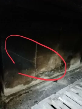

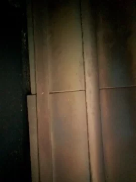

The firebrick cracks are pretty normal for a stove this age. They don't need to be replaced yet. Not sure about the dark line near the door. If it's a crack, that's an unusual location for one. It will need eyes on site to determine. Two important things to look for are any cracking in the base around the grate and the condition of the baffle.
Reactions: Chive

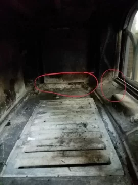

Thanks for your reply! So assuming there’s no cracking around these two points you mentioned do you see anything else visually from the pics? I did circle one other area in the one picture I forgot to mention along the side wall where it looks like the cement has started to break away. Is this common and is it an easy fix?

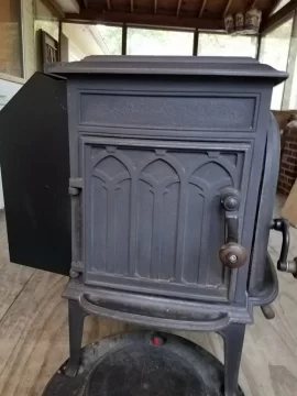

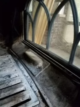

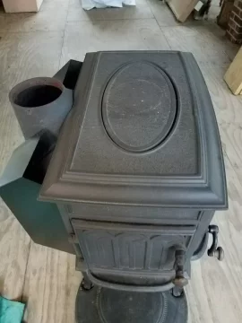

The stove looks in decent condition from the pictures. As for the missing cement, that wouldn't be a showstopper for me but it's better to let veteran F500 owners comment on that.
Reactions: Chive
Nothing leaps out at me ... from the picks the grate looks to be in decent condition although one end seems slightly higher than the other ... as mentioned you will want to look it over in person.
I'm also wondering if that is a crack in the bricks or a line from ash or char as I've seen this before in my stove. In either case this should not be a deal breaker as the bricks are old and if this is a crack it appears to only be a hairline crack.
What looks to be some missing cement may also not be a major issue ... I end up smearing some new cement into some spots in the firebox at the start of the season where chunks of the inside are missing. Again ... you will want to take a closer look.
The crack ... as Bearden said this would be an odd place for a crack ... this may be a crack or something else.
If the price is right I would take a closer look.
If that pic is showing the baffle above the firebox I would guess the stove is older than eight years ...or the baffle was replaced at some point since my 2008 Oslo baffle is one piece.

Thanks for the reply! So is there an easy way to find the year it was made? I know companies like VC actually stamp their year inside the casting firebox. I’m dealing with someone from another state right now so I’m trying to avoid unnecessary driving and wasting of time. There is always that fear of buyer beware so I try and be diligent.
The year on some VC castings is the casting date, not the stove date. They could have been cast up 3 yrs at a time.
Usually the stove date is on the UL label on the back of the stove, but I think the F500's may be part of the serial number. If you can post that maybe stovelark can have a tech uncode it. As Jake noted though, the F500 underwent a baffle style change around/before 2005? The old style was a solid iron baffle and was changed to a vermiculite one in newer models.
Jake, are you referring to the grate not being level front to back? You don't have that? My 2000 vintage stove has little feet on the grate casting. The gate can go in either way. Elevated in the back or front. I never saw that It makes any difference. I never knew why it was made like that. Anyone know?
Chive, My stove was built before 2000. It has those 2 piece removable cast iron burn plates on top of the burn tubes. Just after that, they made the burn plate a one piece synthetic material. So I think the stove is as old as mine. Some here say you can warp the plates. Mine are not, and they just sit there and slide out. There is an insulation blanket that sits on top of them. I never understood why they changed the plates from a durable cast iron. We only burn on weekends and don't need to run it extremely hot. Overheating can be death to any stove. Besides needing a little cement the seams, The issue I see. What appears to be a crack on the front. That's bad!!!, Stove is done. If there are no cracks anywhere, IMO its one of the finest stove.
Soo, how much? I'd want to pay like $500, but maybe up to $1000. It will need something at some point, I'd not want to have toooooo much into it I guess.
i think mine was around $1800 in 2000. Paid more for the glass finish. Which we say was a home run. Done nothing except door gasket and insulation blanket. What are they now?

Hmm, not a owner but if the stove has an ash pan perhaps the odd location cracks formed due to keeping the ash pan door open during start ups? Just some food for thought.
